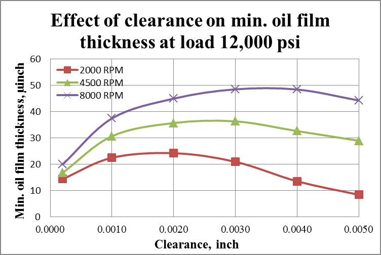

            The most important hydrodynamic parameter affected by oil clearance is the value of minimum oil film thickness. It should be as great as possible in order to prevent metal-to-metal contact between the crankshaft journal and the bearings. The results of the calculations of the effect of clearance on min. oil film thickness are presented in Fig.2 and 3.
            Fig.2 Effect of oil clearance on min. oil film thickness at load 5,100 psi
            Fig.3 Effect of oil clearance on min. oil film thickness at load 12,000 psi
            The calculations prove that optimal oil clearance (clearance providing the greatest value of min. oil film thickness) depends on the rotation speed and load applied to the bearing. An increase of oil clearance provides two opposite effects on the value of oil film thickness. On the one hand, oil film thickness increases due to the formation of a larger supporting oil wedge. On the other hand, non-uniformity (localization) of oil pressure, caused by excessive clearance, results in a decrease of oil film thickness. Oil pressure distribution has a peak close to the location of minimum oil film thickness. The value of the peak is dependent on the average load applied to the bearing, the journal rotation speed, lubricant viscosity and the value of journal eccentricity “e” (Fig.1) relative to the bearing. The non-homogeneity of oil pressure distribution is characterized by the ratio Pmax/Pav.

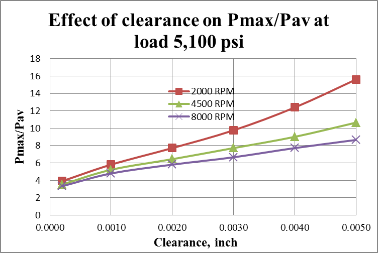

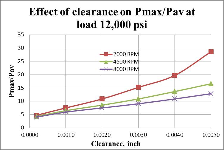

            Excessive clearance can produce a decrease in min. oil film thickness, resulting in undesirable metal-to-metal contact. It may also cause fatigue of the bearing material in the area of peak pressure. This phenomenon is known as knocking. The effect of clearance on oil pressure distribution is presented in Fig.5 and 6.
            Fig.5 Effect of oil clearance on distribution of oil pressure at load 5,100 psi
            Fig.6 Effect of oil clearance on distribution of oil pressure at load 12,000 psi
            These graphs depict that clearance exceeding 0.003” (in our 2” bearing diameter study) results in substantial non-homogeneity of oil pressure distribution. One of the most wide spread causes of engine bearing failure is oil starvation. Insufficient oil supply may be caused by problems with the oil pump, clogging of oil passages or by excessive leakage of oil out of the bearing due to excessive clearance. Oil leakage has an important positive role – it removes the heat absorbed by the bearing, thus preventing overheating of the oil. However, too large a flow of oil leakage may cause a drop of oil pressure and even oil starvation, which terminates hydrodynamic lubrication. Besides oil clearance, oil viscosity affects the oil leakage rate. Oils having greater viscosity better support oil pressure and reduce oil leakage from the bearings. The influence of clearance on oil flow is seen in Fig.7.

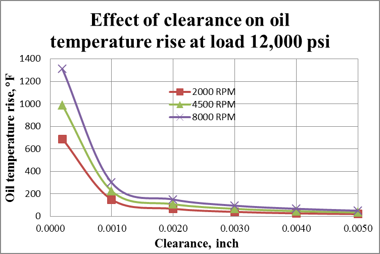

            This graph shows that low oil clearance provides low oil leakage and more uniform distribution of oil pressure. However, oil clearance should not be too low due to the following adverse effects: - Tight clearances generate lower hydrodynamic force, which causes a decrease of min. oil film thickness (see Fig.2 and 3). - Bearing housings and crankshaft may distort/deflect at high loads and high rotation speeds. These distortions are much more dangerous in bearings with small clearances. - Excessive heating of the oil caused by friction energy generated at the bearing by high journal rotation speeds. The effect of clearance on oil temperature rise (delta T) is depicted in Fig.8.
            Fig.8 Effect of oil clearance on oil temperature rise

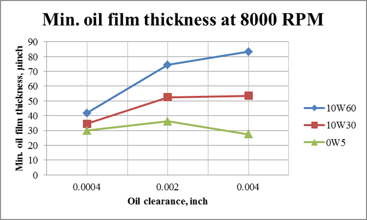

            The effect of oil clearance on minimum oil film thickness for oils with different viscosity and at various rotation speeds is demonstrated in Fig.9.
            Fig.9 Effect of oil viscosity on minimum oil film thickness at 2000, 4000 and 8000 RPM
            The positive effect of oil viscosity on min. oil film thickness for any rotation speed and any oil clearance is evident from the graphs. However, the effect becomes more considerable at greater clearance. The calculations prove that the most viscose oil, 10W60, provides the most stable hydrodynamic regime of lubrication (the greatest value of minimum oil film thickness) with an oil clearance of 0.004” (1/500 of the bearing diameter). Only at the rotation speed of 2000 RPM does minimum oil film thickness slightly decrease (from 41.6 to 35.0 µinch) when the clearance is increased from 0.002 to 0.004”.
            The behavior of the most fluid oil (0W5) is quite different. At relatively large clearances its viscosity is too low to create hydrodynamic force sufficient to maintain the required level of min. oil film thickness. This effect is most prominent at low rotation speed 2,000 RPM. The greatest value of oil film thickness is achieved at the lowest clearance of 0.0004” (1/5000 of the bearing diameter). The oil grade with a moderate viscosity index, 10W30, demonstrated the most stable hydrodynamic regime at the clearance value of 0.002”, which equals 1/1000 of the bearing diameter.
